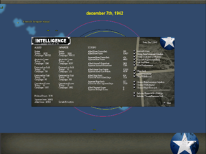

    +396
    7 divembre 1942
    e' passato un anno di guerra...
    che ne pensate?
    mi pare di essere andato benino, per ora

    3174 punti politici? ma non hai liberato nessuna unità? cambiato nessun comandante?
    non voglio smontarti, ma una cosa è la deficienza artificiale, altra è un cohimbra qualunque

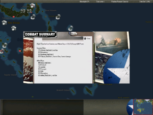

    Battaglia navale tulagi
    i giapponesi provano di nuovo ad avvicinarsi, ma vengono intercettati dalla mia flotta da battaglia, comandata dalla BB Idaho.
    ed ora i potenti mezzi del combat reporter:
    Night Time Surface Combat, near Rekata Bay at 113,133, Range 4,000 Yards
    CVL Ryujo, Shell hits 3, on fire
    DD Shinonome
    DD Shiokaze, Shell hits 2
    DD Yakaze, Shell hits 1, heavy fires, heavy damage
    BB Idaho, Shell hits 1
    CA Portland
    CL Leander
    DD Farragut
    DD Hull
    DD Monaghan
    DD Alden, Shell hits 1, on fire
    Reduced sighting due to 0% moonlight
    Maximum visibility in Overcast Conditions and 0% moonlight: 4,000 yards
    Range closes to 21,000 yards...
    Range closes to 16,000 yards...
    Range closes to 11,000 yards...
    Range closes to 8,000 yards...
    Range closes to 6,000 yards...
    Range closes to 4,000 yards...
    CONTACT: Japanese lookouts spot Allied task force at 4,000 yards
    CONTACT: Allied lookouts spot Japanese task force at 4,000 yards
    DD Shiokaze engages DD Alden at 4,000 yards
    DD Shiokaze engages DD Hull at 4,000 yards
    DD Shiokaze engages DD Farragut at 4,000 yards
    BB Idaho engages CVL Ryujo at 4,000 yards
    DD Yakaze engages DD Farragut at 4,000 yards
    DD Alden engages DD Shiokaze at 4,000 yards
    DD Shinonome engages DD Alden at 4,000 yards
    DD Shinonome engages DD Monaghan at 4,000 yards
    DD Farragut engages DD Shiokaze at 4,000 yards
    DD Yakaze engages DD Monaghan at 4,000 yards
    CL Leander engages CVL Ryujo at 4,000 yards
    DD Shinonome engages DD Hull at 4,000 yards
    DD Hull engages DD Yakaze at 4,000 yards
    Range increases to 6,000 yards
    BB Idaho engages CVL Ryujo at 6,000 yards
    CA Portland engages CVL Ryujo at 6,000 yards
    CL Leander engages CVL Ryujo at 6,000 yards
    DD Farragut engages DD Shinonome at 6,000 yards
    DD Monaghan engages DD Yakaze at 6,000 yards
    DD Farragut engages DD Yakaze at 6,000 yards
    Range increases to 9,000 yards
    BB Idaho engages CVL Ryujo at 9,000 yards
    BB Idaho engages DD Yakaze at 9,000 yards
    DD Monaghan engages DD Shiokaze at 9,000 yards
    DD Alden engages CVL Ryujo at 9,000 yards
    Japanese Task Force Manages to Escape
    Task forces break off...
    Night Time Surface Combat, near Rekata Bay at 113,133, Range 2,000 Yards
    DD Shinonome
    CA Portland
    CL Leander
    DD Farragut
    DD Hull
    DD Monaghan
    DD Alden, Shell hits 2, on fire
    Maximum visibility in Overcast Conditions and 0% moonlight: 3,000 yards
    Range closes to 2,000 yards...
    CONTACT: Japanese lookouts spot Allied task force at 2,000 yards
    CONTACT: Allied lookouts spot Japanese task force at 2,000 yards
    BB Idaho engages DD Shinonome at 2,000 yards
    DD Alden engages DD Shinonome at 2,000 yards
    BB Idaho engages DD Shinonome at 6,000 yards

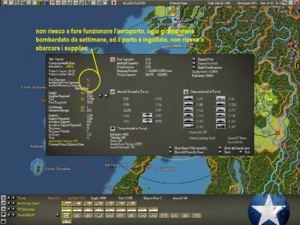

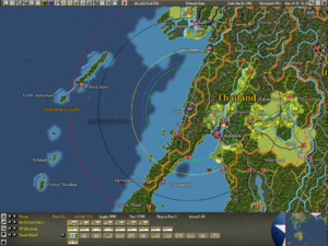

    Da Tavoy a Bangkok
    ecco la situazione aggiornata al 15/12/1942
    La situazione di tavoy è la seguente:
    la spedizione vicino al fiume di bangkok è la seguente, ma non capisco come sono messo coi supplies, cioè come fare ad averli:
    cosa ne pensate?
  11. cohimbra
    cohimbra Guest
    L'aereoporto dovrebbe funzionare, la pista ha soltanto 28 punti di danneggiamento (i 79 punti di Service Damage
    lasciali perdere, vuol dire che gli aerei danneggiati non verranno riparati, ma basta impedire il bombardamento
    delle piste per due/tre turni e tutto torna a posto)...davvero la caccia non ti vola? Ho avuto una situazione molto
    simile nella mia partita a Darwin (uguale Service Damage mentre Runaway Damage leggermente inferiore) ma i
    miei Zero si sono alzati ugualmente in volo. Riguardo al porto: finchè è danneggiato non fare attraccare i convogli,
    scaricano meglio come 'undocked'...anche se in realtà il porto è piccolo, per scaricare ingenti quantità di materiale
    ci vorrà comunque del tempo, porto danneggiato o meno.
    edit: i supplies si muovono molto lentamente via terra in quelle zone (terreno impervio e strade piccole), è normale
    avere difficoltà di approvvigionamento.

    Credo sia il classico GCSMLC
    Se non scarico i supplies non riesco a far crescere il porto e così non riesco a scaricare.
    Sto scaricando sempre da anfibio, non docco.
    Ho portato le migliori squadriglie di caccia da rangoon.
    I giapponesi attaccano ogni giorno con decine di bombardieri e non riesco ad avere aeroporto funzionante.
    Gran parte della mia caccia e stata distrutta o danneggiata al suolo.
    Pochissimi si sono levati in volo.
    Non riesco ad impedire il bombardamento delle piste, come vedi ho portato tutte le antiaeree che avevo in zona, ma sono troppi gli aerei giappo.

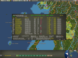

    sulle navi o nel porto?
    cosa intendi per squadra di genieri?
    nel la base di Tavoy ne ho parecchie di unità di genieri, come da immagini allegate.
    ma non capisco se convenga portare una task force da sbarco alla volta (metodo sequenziale) o più insieme (in parallelo).
    chiedo perchè nei porti piccoli (1-3 circa) ci mettono sempre settimane a scaricare.
